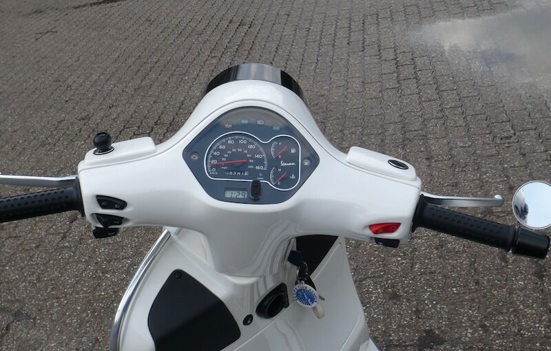

    Finally i took some pictures of my 2009 GTS 300 ongoing project.
    I bought this 300 second hand with only 1800 km on the tacho.
    So far i did these mods :
    Cosmetical :
    *13 inch Yourban wheels painted gloss black
    * White reflective rim striping
    * Debadged
    * Leds all round.
    * Daylight "running" lights using bottom front indicators : [topic107774]
    * Osram H4 Night breaker headlight
    * Smidsy Brake light modulator : [topic94916]
    * 70 mm "Fake" Oberon mirrors using original bar ends painted black.
    * Piaggio Vespa mono gel saddle : [topic107657]
    * Jettin black short visor
    * Ram mount for GPS + power cable : [topic76820]
    * Chrome nose grill painted black
    * Dashboard painted black
    Mechanical :
    * Oil temperature gauge
    * Malossi springs front & rear
    * Optima 4 battery charger connector (lengthened & repositioned to the rear)
    * Remus SS exhaust without cat. DB killer "tuned" for some extra "excitement".
    * Repositioned the attachment of the spring from the side stand so it remains in it's open position.
    * 19 gr Dr. Pulleys
    Tried but failed :
    * PM adjustable levers.
    * Changing front fender ornament
